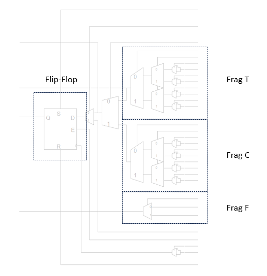

Posts: 35
Joined: Fri May 15, 2020 8:27 am
The FPGA Logic Cell in EOS S3 can be fragmented into four pieces
[img][
PP3 .png (23.93 KiB) Viewed 403708 times
/img]
The frag F is also referred to as b.
