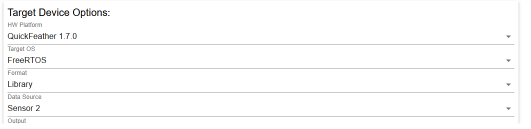

When you are downloading from app.sensiml.com - select library in output format:
if this is not available, let us know, as Community edition should still be able to get this format.

Hello, I was having the same issue initially. But after some investigation and trial/error, I think I found an answer to it. We need to select the debug option when we download the knowledge pack. This works for me.
I have a somewhat strange finding though, when the project is using accelerometer, I don't need to tick this debug option to have the serial output. This only needed when I use the audio sensor.
