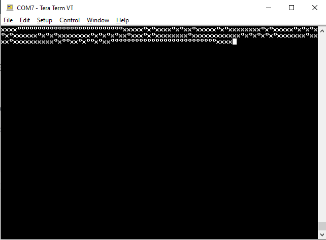

Hi, I'm using QuickFeather microphone data to make the model, data aquastion and modelling done by following the tutorial, but after flashing the .bin Knowledge Pack , with 460800 buad mentioned in the doc https://sensiml.com/documentation/firm ... le-stream . The classification results is not printing , Any Idea?

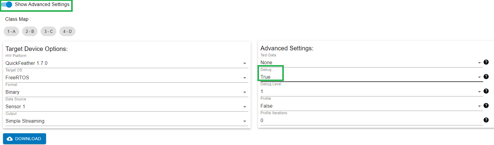

Hello, I was having the same issue initially. But after some investigation and trial/error, I think I found an answer to it. We need to select the debug option when we download the knowledge pack. This works for me.
I have a somewhat strange finding though, when the project is using accelerometer, I don't need to tick this debug option to have the serial output. This only needed when I use the audio sensor.
