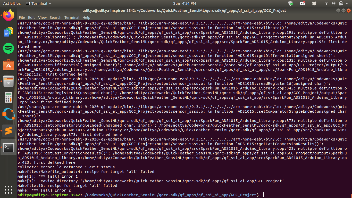

Hello @jmoore. I have been continuing my work on my project. I used an ADS1015 to stream 3 sensors' data to the Quickfeather. I managed to follow the documentation for the Simple Streaming Interface project and despite the documentation not being in very detailed, I managed to make the necessary changes to remove multiple errors. But when I am executing the make command, it exits with an error. I did a make clean and make again but I am still getting the same error. I have attached a screenshot of the terminal. Please offer your expertise with what I can do to solve this error as I am unable to figure out the issue here.
Make command output
Make command output
Screenshot from 2021-02-14 16-54-50.png (318.44 KiB) Viewed 107463 times

From the error It appears that functions in SparkFun_ADS1015_Arduino_Library.cpp are compiled twice. Please verify that these functions are included in only one source file.

Reviewed the source_files.zip, please remove the following Line#39 in sensor_ssss.cpp
#include "SparkFun_ADS1015_Arduino_Library.cpp"
The above statement is causing this to be compiled twice.

Thank you very much! I tried your suggestion and it work now. Now I can proceed further. Thanks once again! :D
