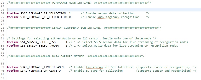

To use the USB-Serial port for data capture change the settings in Fw_global_config.h file in qf_apps/qf_ssi_ai_app/inc folder as below:
Code: Select all
#define DEBUG_UART  (UART_ID_HW)  // Set the output of debug messages
#define UART_ID_APP  (UART_ID_USBSERIAL)       // Set the output for application messages

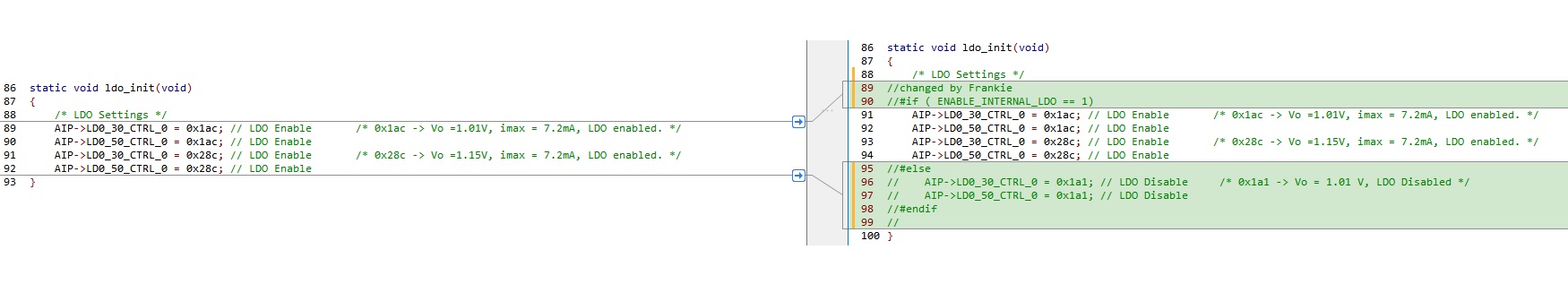

For the question about why qorc-sdk v1.10 is not working with DCL, I did a comparison with v1.9 and made a modifications as attached file.
After modifications, it works with DCL but no idea why ldo is the cause of this problem?

murthy.vedula wrote: ↑Fri Feb 04, 2022 6:51 pm To use the USB-Serial port for data capture change the settings in Fw_global_config.h file in qf_apps/qf_ssi_ai_app/inc folder as below:
Code: Select all
Many thanks for the solution.
