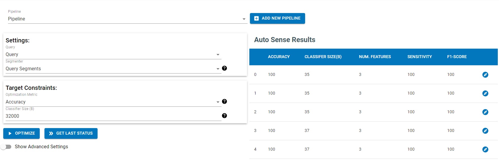

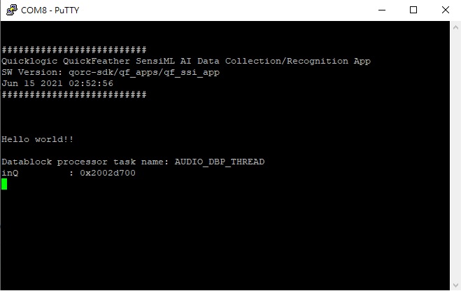

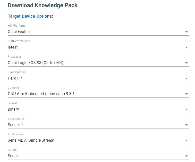

as tiled, no idea why no classification result output from serial output?
debug is enabled as well.

Please try HW UART, instead of USB SERIAL.
