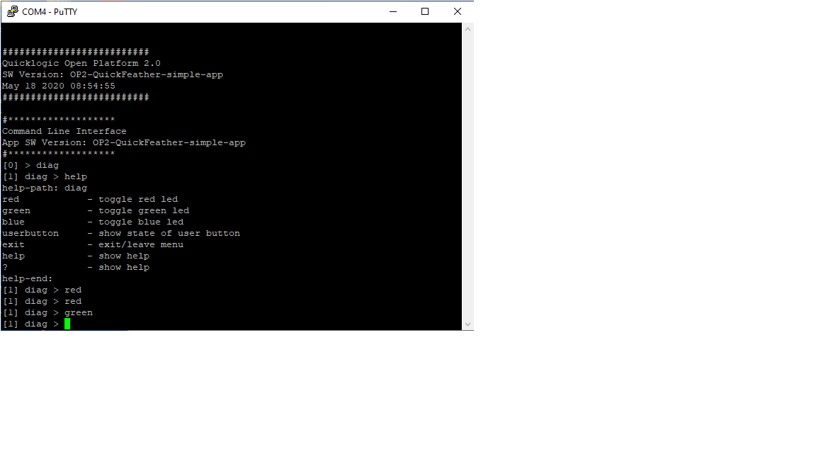

Successfully done on my Windows10 laptop.
Note.
- Appears with COM4 port on my laptop
- SW Version ; OP2-QuickFeather-simple-app as default
QF init.png (21.69 KiB) Viewed 85259 times
