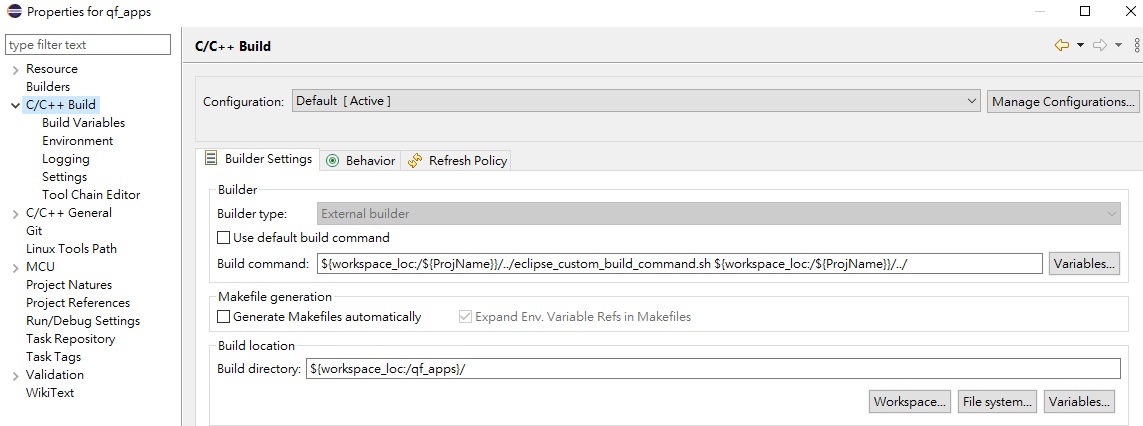

I am trying to convert existing Makefile GCC_Project to an Eclipse Project in windows 10 as followings.
https://github.com/QuickLogic-Corp/qorc ... clipse.rst

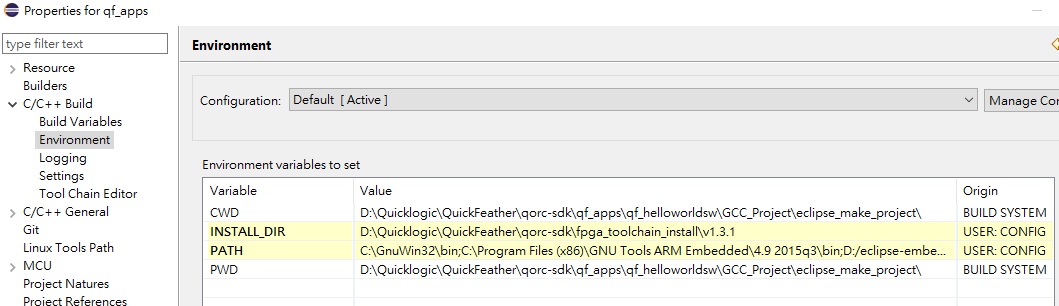

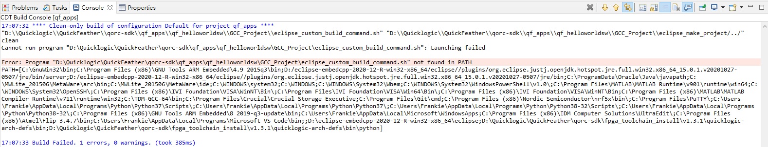

In the C/C++ Build/Environment setup, "Path to the ARM GCC Toolchain Directory":"$INSTALL_DIR/install/bin:$INSTALL_DIR/install/bin/python:$PATH have to be added into PATH. But there is no "install/bin" and "install/bin/python" directory in my D:\Quicklogic\QuickFeather\qorc-sdk\fpga_toolchain_install\v1.3.1\quicklogic-arch-defs directory.
BTW, no idea why toolchain path is using backslash and PATH is using slash and backslash for the location directory.
