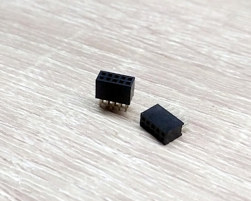

battlecoder
How did you make the 10 pin SWD connector?
Re: Connection problems.
Posted: Sun Mar 28, 2021 1:28 am
by battlecoder
MaxPower wrote: ↑Sat Mar 27, 2021 9:52 am battlecoder
I was lucky to have a small 10 pin (5x2) header with 1.27mm spacing that I once bought for small OLED displays, and they fit perfectly on the SWD connector on the board.
