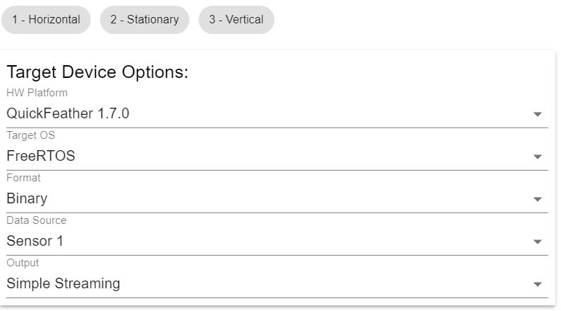

These are my download setting for the Slide Demo:
Does anyone know what could be the issue? Thanks in advance for any tips!

Thanks for the link. I tried enabling the "Debug" option as suggested, but I still don't get any output. I also tried with the "Library" version of the knowledge pack, both with and without "Debug" enabled, still no luck.
