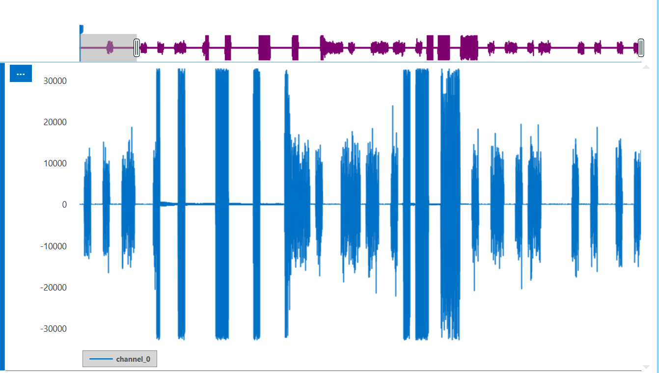

Bunch of noises in the audio data
juanyi
Posts: 19
Joined: Thu Jan 28, 2021 7:38 am
I was trying out some simple spelling to the quickfeather. The audio data collected in DCL contains a lot of noises, did anybody know how to filter/remove the noises or configure/fine-tune the onboard Infineon mic? The model failed miserably with this kind of data.

shimemar wrote: ↑Tue Feb 09, 2021 11:51 pm Hello
I also confirmed, but the situation is the same.
It's the same even if I attach a microphone to the outside, so I'm giving up using it now.
So you attach a 3rd party microphone?
I'm hoping somebody from QuickLogic to get us through this but still no reply from them, I wonder do they look at this forum or not. Anybody else having the same issue here?

Please let us know which QORS_SDK version you used for collecting audio data. The latest tag version 1.7.0 has improvement to eliminate the noises seen in some systems. Link https://github.com/QuickLogic-Corp/qorc ... tag/v1.7.0

I was using v1.5.0 before. Same noise issue even I tried v1.7.0. Could it be some fine-tuning or pre-processing needed for the MIC?

The issue is reported to internal team. We are working on validating the issue and will look for solution. Stay tune.

This should be fixed in the latest DCL release (2020.10.6, or you may see an update for 2020.10.7 come Monday the 8th.)

Yes, thanks for the remedy! It audio data is clean now.
