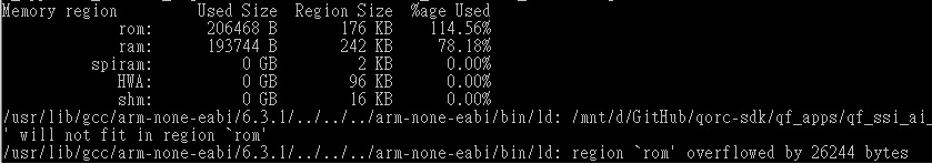

Quick feather region rom overflow

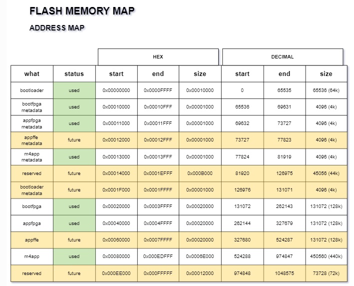

As picture attached, rom size is not enough after adding some sensor drivers. How to add more space in rom region? I found quickfeather.ld in GCC_Project folder and the origin for ROM section is 0x00. As my understanding, 0x00 is for bootloader and 0x80000 is for m4app. Is quickfeather.ld the right file for qf_ssi_ai_app?

BTW, should we modify tinyfpga-programmer-gui.py to meet the changes of rom region in .ld file?
It works after change the rom length and modify the origin address for the other section in quickfeather.ld.
MEMORY
rom (rx) : ORIGIN = 0x00000000, LENGTH = 0x00040000
ram (rwx) : ORIGIN = 0x20040000, LENGTH = 0x0003c800
spiram (rw) : ORIGIN = 0x2007c800, LENGTH = 0x0000800
HWA (rw) : ORIGIN = 0x2007d000, LENGTH = 0x00018000
shm : ORIGIN = 0x20095000, LENGTH = 0x00004000
Memory region Used Size Region Size %age Used
rom: 206228 B 256 KB 78.67%
ram: 193744 B 242 KB 78.18%
spiram: 0 GB 2 KB 0.00%
HWA: 0 GB 96 KB 0.00%
shm: 0 GB 16 KB 0.00%
