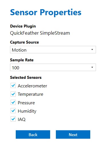

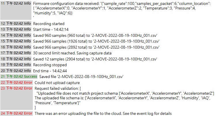

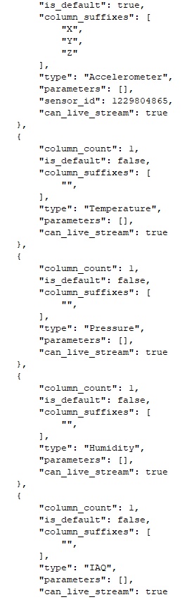

I modified the .ssf file to add more sensors for data capturing. After recoding, the file is saved but uploaded fail. No idea how to fix this.

This problem is fixed by creating a new project with new configuration.
