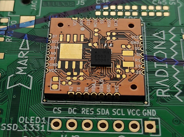

I bought EOS3 BGA on CrowdSupply and as II started to work on my board I discovered that it would be hard to make it at low price.
If I would do it correctly I would need to use small vias, probably buried vias so for few boards that did not make sense to me...
But as I still wanted board I had some idea to do it hacky way.
If I do not use VIA under BGA then all will be good and cheap.
I tough that one of two approaches should work.
First idea was to use just the pins I need - and not to place pads for the pins I do not need.
But then I looked at the datasheet and as I discovered some pins in datasheet some pins would not mind if they are connected on startup I used other approach.
Connected some pins together so if that would work I could use more pins at the end...
I ordered board from OshPark -
https://oshpark.com/shared_projects/bjR6vplZ

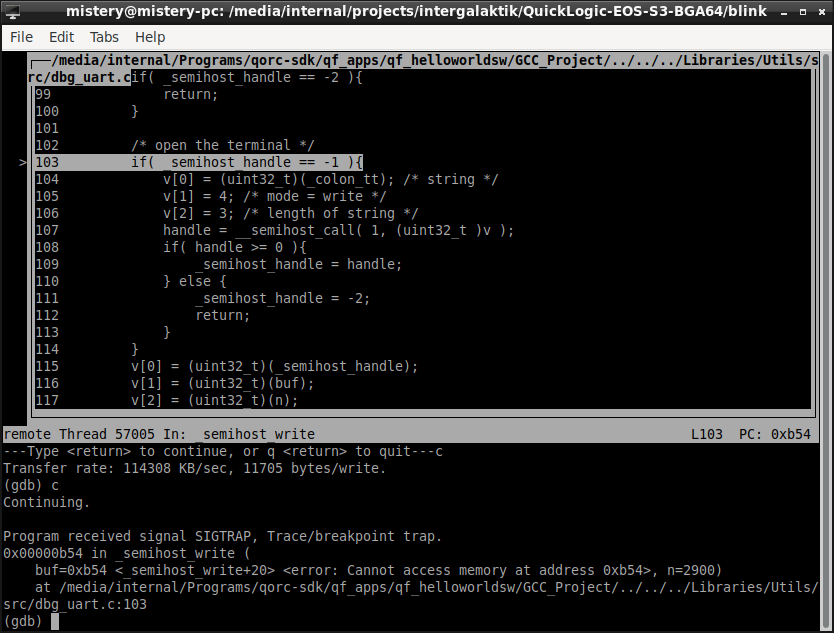

I assembled board and start to study tool chain.
Finally understood how to "compile" everything, but I run on the issue.
https://github.com/QuickLogic-Corp/qorc-sdk/issues/86
Problem is that I can load fw to board, but LED does not blink and if I connect to debug board I see
Problem is that now I an stuck as I tried many things in software, and I am not sure that HW is done right.

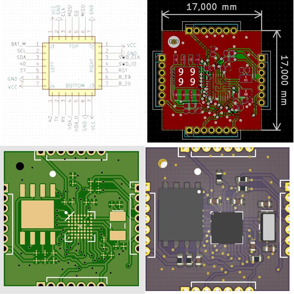

So if someone who knows architecture could check my board and schematics for things I did bad - that would really help me to get i running.
Board is here: Cheap version QuickBGA64_cheap.pro is the one I am referring to, as in the same repo there is other unfinished board...
https://github.com/intergalaktik/QuickL ... QuickBGA64
Board now has all parts on, with addition of BOOT jumpers and LED on other pin for testing...
