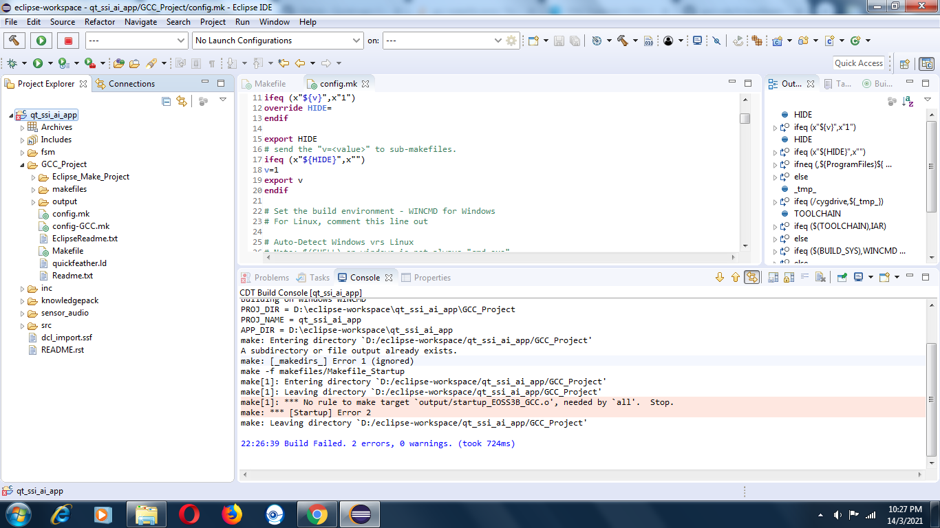

Posted: Mon Mar 15, 2021 10:59 am
by timothym
I have downloaded all requirements and configured the eclipse as instructed in https://github.com/QuickLogic-Corp/qorc ... Readme.txt
but while building the project I am getting the following error

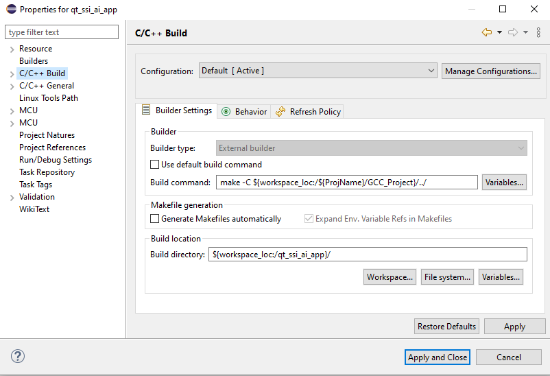

my build settings are following
can anyone please help urgently.....thanks

I think the way to create virtual project did matter.
Below is my working setup
