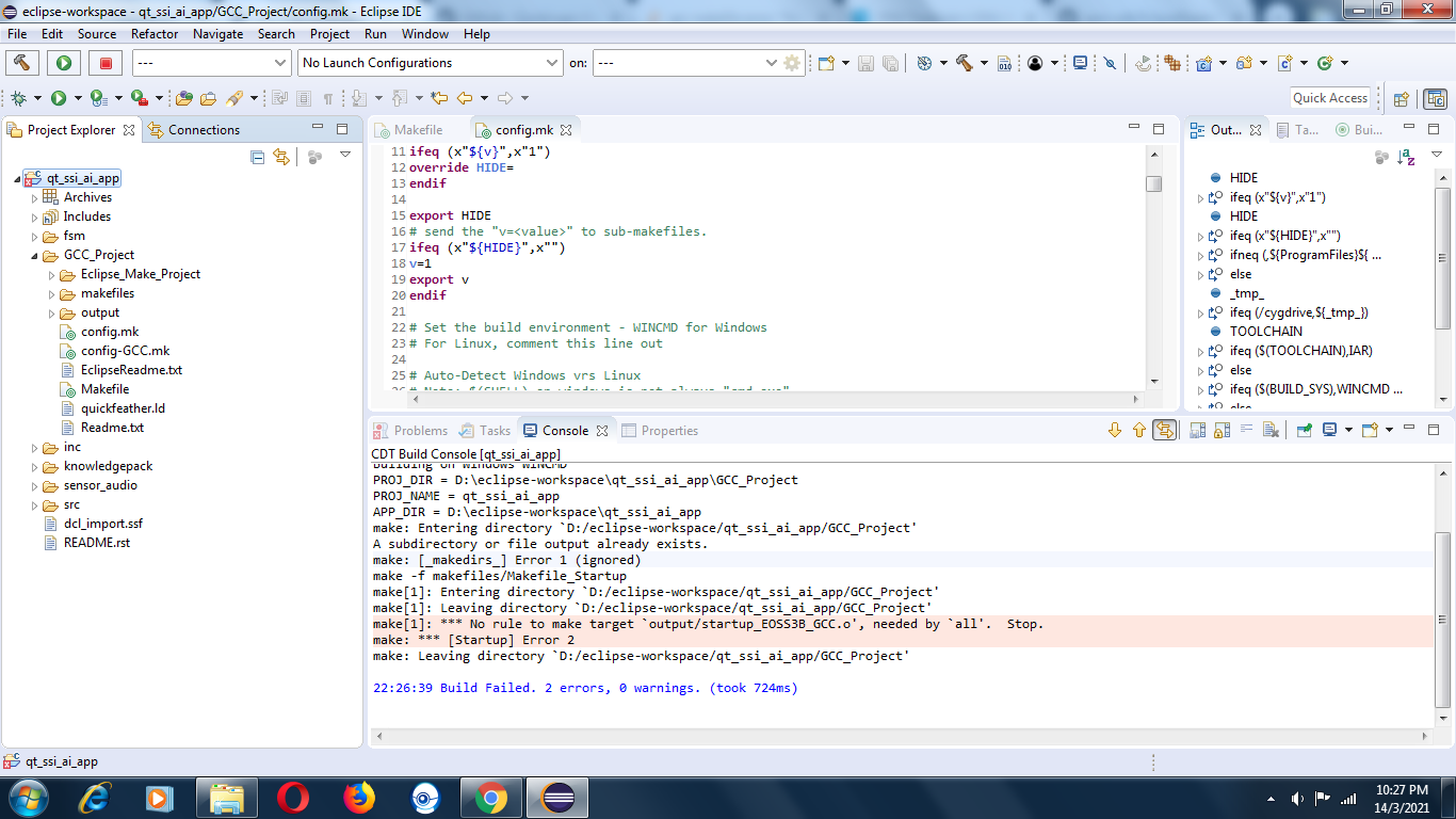

but while building the project I am getting the following error

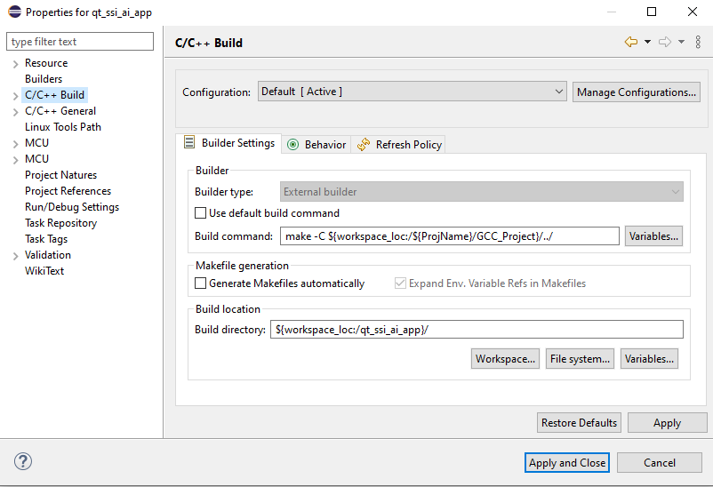

my build settings are following

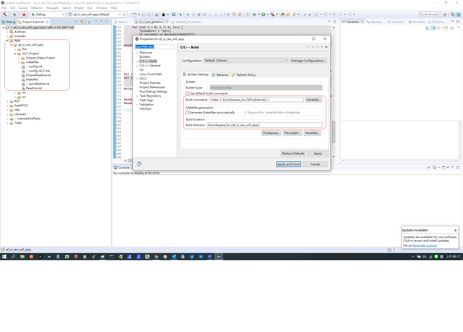

Below is my working setup
