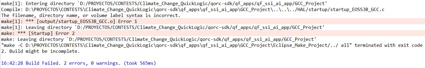

I followed the video tutorial mentioned above (I'm on Windows 10).When trying to clean/build the project, I get the following error:
I can see there's a mixture of '/' and '\' in the paths, for instance for the 'HAL' folder. I'm not sure if that's the problem, I couldn't find a way to correct it. Any suggestions?
Thanks in advance!

I believe this is the similar issue like viewtopic.php?f=19&t=84&p=359&hilit=eclipse#p359

phil_quik wrote: ↑Mon Mar 22, 2021 11:05 pm I believe this is the similar issue like viewtopic.php?f=19&t=84&p=359&hilit=eclipse#p359
Thanks for your prompt answer!
The link helped very much. In my case, I just deleted from my PATH env. variable a reference to another toolchain I had from an old Eclipse installation.
