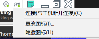

Hello,
I'm able to connect QuickFeather to WIN10 and run the default app. However, when I tried running the same on ubuntu running in VMWare Player, the COM port can't be connected to VM. I selected 'connect to VM' when the prompt appears, and I saw the 'OpenMoko USB Device' icon appears on the VMWare status bar, but it's actually not connected to it, as it says 'Connect (disconnect to Host)' which indicates it's connected to host machine. When I click the 'Connect', it shows me 'unknown error'.
screenshot
screenshot
Did anyone ever hit similar issue?
Thanks

Please see the discussion on below post, which is similar to this issue.
viewtopic.php?f=18&t=28
Please try the solution provided.
