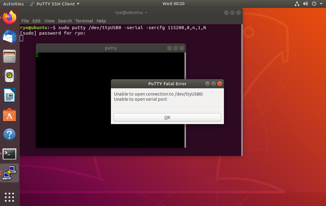

following the instruction on Working.with.Zephyr.pdf (Revision: 0.1.0) , but not able run putty due to fatal error.
thanks for your advice.

The serial port is not available on ttyUSB0. That is the error.
Make sure the connection is proper and find out which port it is connected on. You can use below command.
On my ubuntu system the output is as below.
Code: Select all
qlblue@Ubuntu184-3:~$ dmesg | grep ttyUSB
[    4.084503] usb 2-1.4: cp210x converter now attached to ttyUSB0
If you are using a virtual box, first you have to expose the USB port to Ubuntu through virtual box. Please refer virtual box documentation on this.
In fact, if you are using virtual box, you can use Tera Term/Putty on windows it self.

I hit the command as
ryo@ubuntu:~$ dmesg | grep ttyUSB
but seems nothing match with ttyUSB.
QuickFether being connected to laptop and select the virtual machine to connect. How can I get the info on Ubuntu18?
thanks,

Tried to enable USB connection on VMWare Workstation and back to the terminal to confirm by typing the command.
[ 1.372396] printk: console [tty0] enabled
[ 5.462632] 00:05: ttyS0 at I/O 0x3f8 (irq = 4, base_baud = 115200) is a 16550A
ryo@ubuntu:~$
then tried with ttyS0 on Putty but seems it's not a correct port to connect to...
Can anyone help to check my connection and advice?

by spingali
Inside the Ubuntu window, click on Device menu and then USB. In the list of ports, see if your serial port is checked. If not select the port. Try again and see if it is checked. Unless the port is marked checked, it will not be available for Ubuntu.
