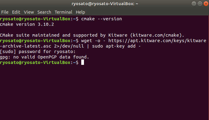

following to the Working.with.Zephyr.pdf (revision: 0.1.0) to have firmware download test for Zephyr, I'm facing the problem to update cmake version on my laptop.
Ubuntu18.04LTS via Oracle VirtualBox on WIndows10
please advice if any.

Please observe the first option passed to the command wget which is "-O" (it is capital O, not small o) . Please try again with capital 'O'

resolved. thank you
