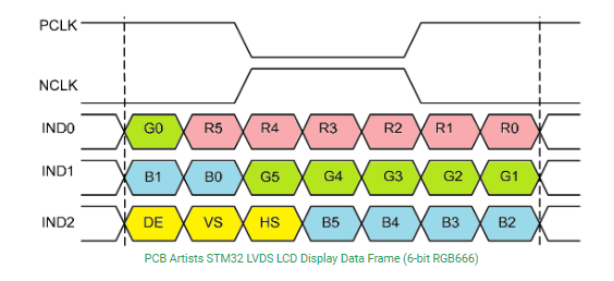

Our customer needs a replacement for NXP PTN3700 RGB-to-LVDS video interface link.
FROM CUSTOMER:
Needs a video bridge that can take 6bit each of R,G,B and put out LVDS that looks like:
The data rate on the LVDS isn’t much…like < 40MHz.
Looks like Articlinc III has a device for this function.
https://www.quicklogic.com/products/dis ... clink-iii/
RGB-to-LVDS part number is: CSSP-BPFDN120
Is this device the right one to consider? Is it programmed by Quicklogic? What is the availability?
