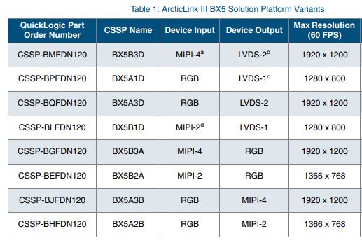

Can you please help, I am having difficulties source the TI MIPI to LVDS display.
I don'thave time to create and validate the FPGA design in the Lattice CrossLink solution, and would prefer an ASSP type solution, to reduce risk and timescales.
I was discussing this with one of your distributors and they mentioned that you may have stock or at least could supply with an acceptable lead-time.
I have different display requirements using both one channel and two channel LVDS
Can you please suggest a device?
What flexibility do you have on your LVDS channel and what resolutions do you support

Thank you for your interest in Quicklogic.
Please let me answer your technical questions and I will get Sales to contact you will availability and lead-time.
You are correct QuickLogic has a family of ASSP display bridges
The devices that you are most interested in are the
Bx5B1D (MIPI to 1 channel LVDS), resolution up to 1280 x 800 - QuickLogic Part # CSSP-BLFDN120
Bx5B3D (MIPI to 2 channels of LVDS), resolution up to 1920 x 1200 - QuickLogic Part # CSSP-BMFDN120
The LVDS is 3v3 and will support 888/666/565 LDI and LVDS
 Digital Interface Standards for Monitor (DISM) v1.0 (JEIDA-59-1999) – LVDS (Standard 2-a)
 Digital Interface Standards for Monitor (DISM) v1.0 (JEIDA-59-1999) – LDI (Standard 2-b) – identical to openLDI
The interface is programmable so that we can include the additional HSYNC/VSYNC/DE bits in the LVDS output stream or provide fix test bits

Recommended QuickLogic Products
Bx5B1D
Function: MIPI to 1 channel LVDS
Maximum Resolution: 1280 x 800
Part Number: CSSP-BLFDN120
Bx5B3D
Function: MIPI to 2 channels of LVDS
Maximum Resolution: 1920 x 1200
Part Number: CSSP-BMFDN120
Technical Information
LVDS Voltage: 3.3V
Supported Formats: 888/666/565 for LDI and LVDS
Digital Interface Standards for Monitor (DISM):
Flexibility
The interface is programmable, allowing the inclusion of additional HSYNC/VSYNC/DE bits in the LVDS output stream or providing fixed test bits. Play cowboy safari

If you're looking for an ASSP replacement for TI’s MIPI-to-LVDS bridges without going through FPGA development, QuickLogic’s Bx5 family is a good fit and is already used in several embedded display designs.
For single-channel LVDS panels, the Bx5B1D (CSSP-BLFDN120) supports up to 1280×800.
For dual-channel LVDS panels, the Bx5B3D (CSSP-BMFDN120) supports up to 1920×1200.
Both devices run at 3.3V LVDS and support 888/666/565 formats with JEIDA/openLDI compatibility. The output interface is programmable, so HSYNC/VSYNC/DE handling can be adapted to panel requirements. lowqualityimage
