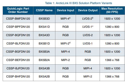

You are correct QuickLogic has a family of ASSP display bridges
The devices that you are most interested in are the
Bx5B1D (MIPI to 1 channel LVDS), resolution up to 1280 x 800 - QuickLogic Part # CSSP-BLFDN120
Bx5B3D (MIPI to 2 channels of LVDS), resolution up to 1920 x 1200 - QuickLogic Part # CSSP-BMFDN120
The LVDS is 3v3 and will support 888/666/565 LDI and LVDS
 Digital Interface Standards for Monitor (DISM) v1.0 (JEIDA-59-1999) – LVDS (Standard 2-a)
 Digital Interface Standards for Monitor (DISM) v1.0 (JEIDA-59-1999) – LDI (Standard 2-b) – identical to openLDI
The interface is programmable so that we can include the additional HSYNC/VSYNC/DE bits in the LVDS output stream or provide fix test bits
Please let me know if you have any additional questions

Bx5B1D
Function: MIPI to 1 channel LVDS
Maximum Resolution: 1280 x 800
Part Number: CSSP-BLFDN120
Bx5B3D
Function: MIPI to 2 channels of LVDS
Maximum Resolution: 1920 x 1200
Part Number: CSSP-BMFDN120
Technical Information
LVDS Voltage: 3.3V
Supported Formats: 888/666/565 for LDI and LVDS
Digital Interface Standards for Monitor (DISM):
Flexibility
The interface is programmable, allowing the inclusion of additional HSYNC/VSYNC/DE bits in the LVDS output stream or providing fixed test bits. Play cowboy safari
