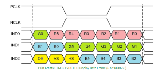

Needs a video bridge that can take 6bit each of R,G,B and put out LVDS that looks like:
The data rate on the LVDS isn’t much…like < 40MHz.
