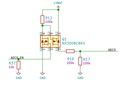

It is a 12-bit ∑Δ Analog-to-Digital Converter (ADC), normally used to measure battery voltage level. If you look at the schematic for QuickFeather you will see that ADC0 is connected to the VBAT

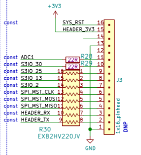

ADC1 Is available on J3 pin 11

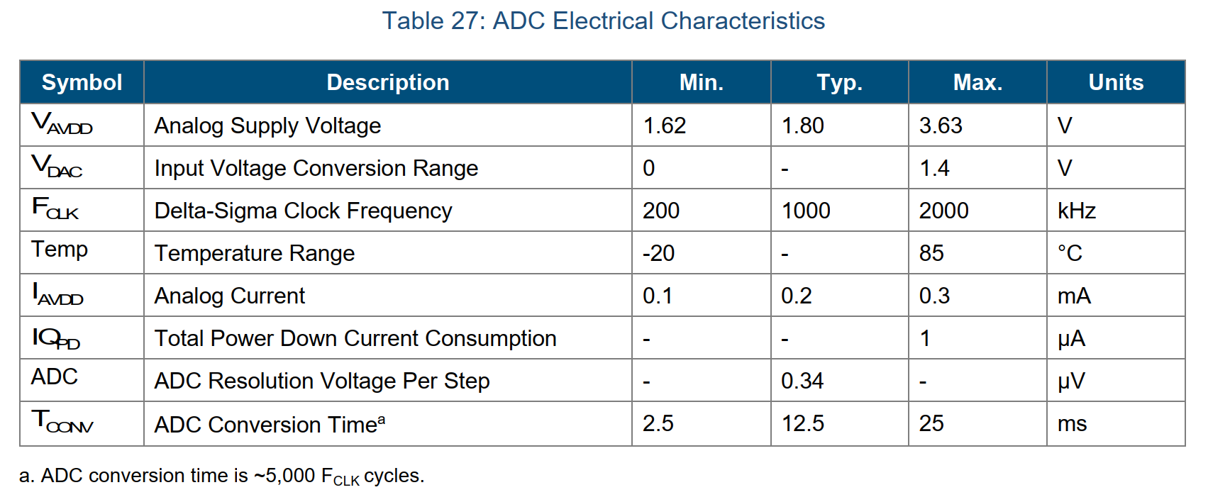

The specification of the ADC is as follows

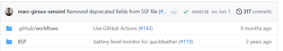

Example configuration for the ADC can be found at https://github.com/QuickLogic-Corp/qorc ... a89816863f
battery level monitor for quickfeather firmware in the above link
