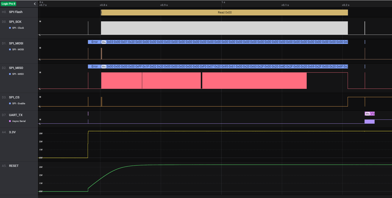

I'm developing a barebones breakout board for the EOS-S3, and have run into a snag with the device behavior at power-on. I implemented a minimal design based on the QuickFeather dev board, and my schematic is here: https://github.com/Blinkinlabs/QL-EOS-S ... _RevB1.pdf
The board fails to boot on power-on, and appears to have some spurious activity on the SPI lines:

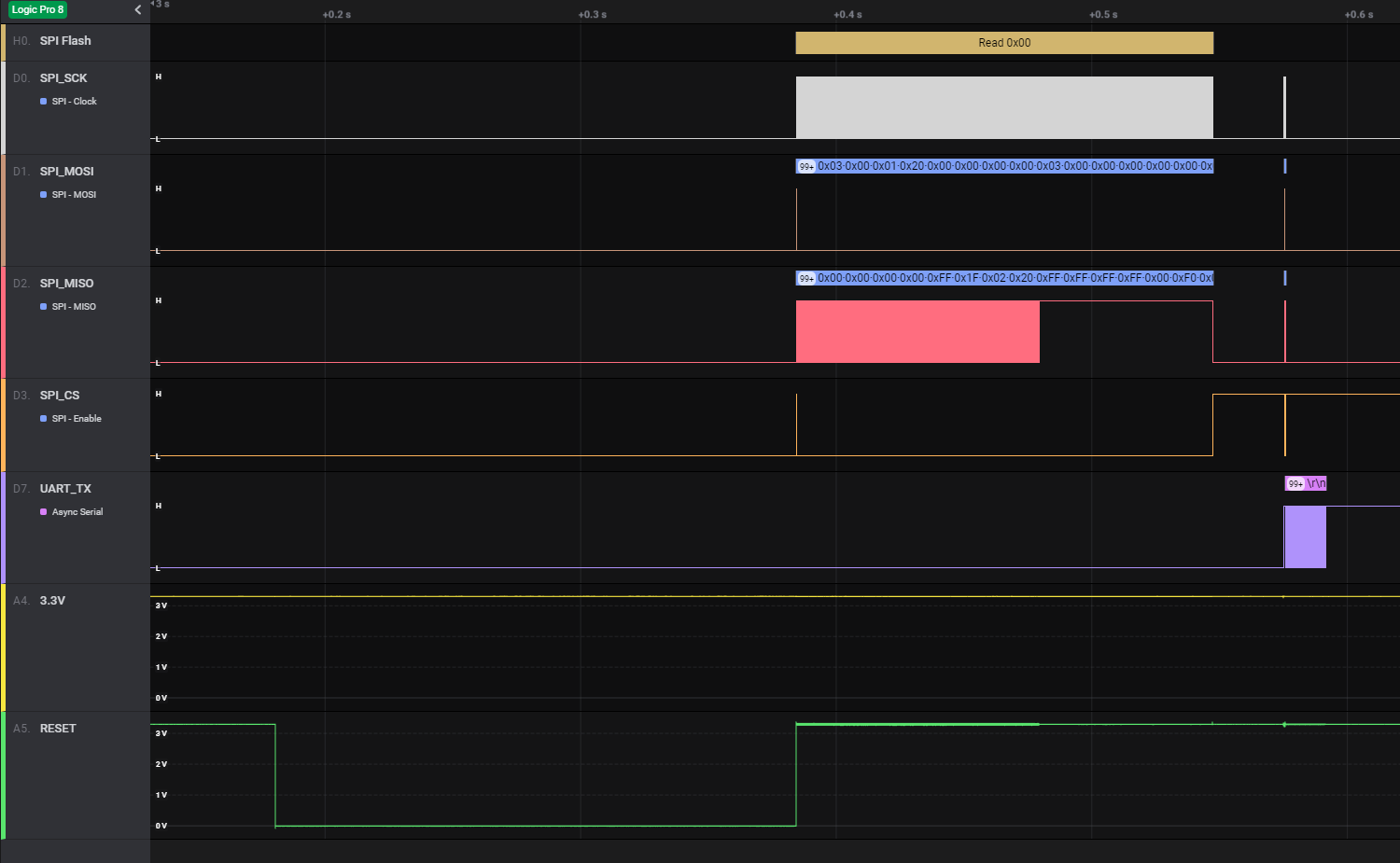

If i press and release the reset button after power-on (or hold it down during reset, then release some time after power-on), the device is able to load and execute the bootloader as expected:
QL_EOS_S3 boot success after pressing reset button.png (47.36 KiB) Viewed 86557 times
According to the Technical reference manual r1.01a, Figure 31-1 the power lines should be brought up in sequence (VCC, then AVDD/VCCIO, then release SYS_RSTn). However, the QuickFeather reference board doesn't seem to take this into account- it has the VDD/AVDD/VCCIO pins tied to the +3V3 line from the voltage regulator, and the SYS_RST line pulled to +3V3 with a 10k resistor.
The major differences I can see are that my board is using the BGA variant of the part, and that my board is using an LDO instead of a buck regulator.
I've tried using slow and fast rising bench supplies, increasing the value of and removing the capacitor on the reset line, but with no noticeable change in behavior.
Are there any obvious mistakes with the power circuit on my board?

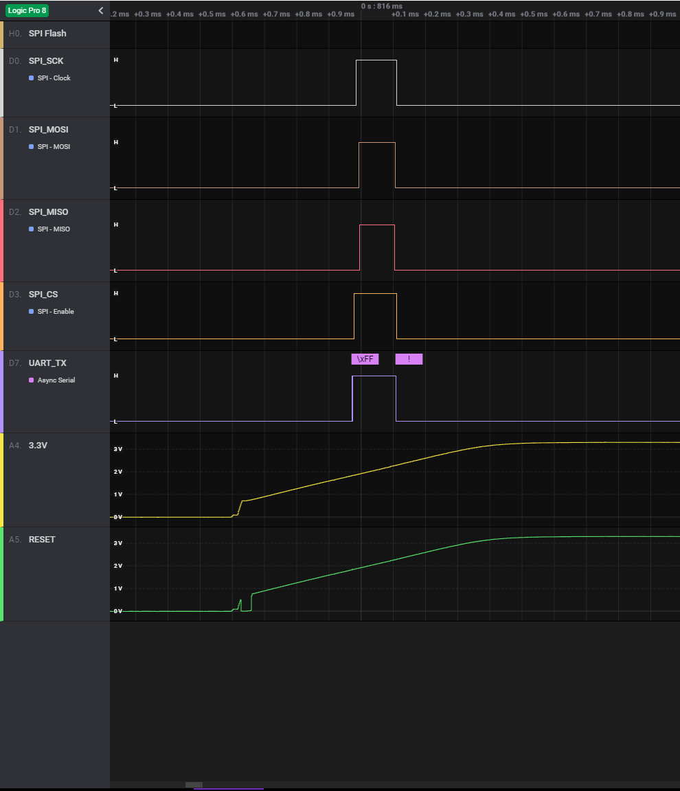

Thanks! I increased the value of C5 to 4.7uF, and it's stretched the rise time on the reset pin far enough to allow it to boot:
QL_EOS_S3 boot success with 4.7uF cap.png (50.67 KiB) Viewed 86536 times
That should be good enough for a dev board. Out of curiosity, is there a more 'production ready' reference design available for the QL-EOS-S3?
